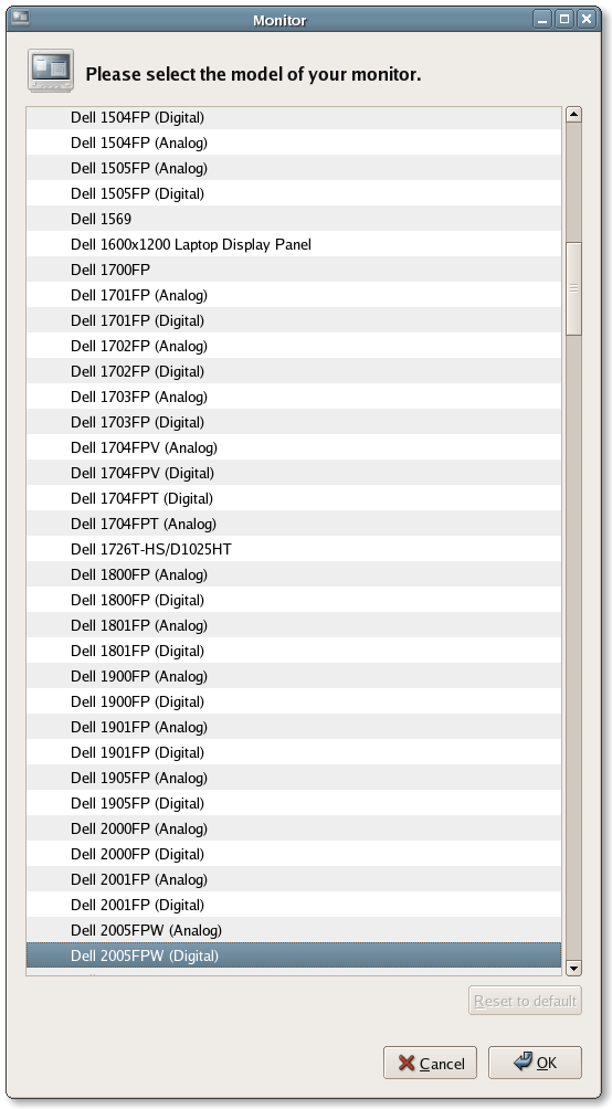

Originally Posted by Pocketfactory
Well one thing I forgot to mention is that the 2005FPW isn't listed in the monitor selection option. It only goes as far as the 2001FPW
Which release of Fedora Core are you using?
I found out late this afternoon Fedora Core 4 does support Dell 2005FPW:
http://fedoranews.org/tchung/2005fpw...ay_Monitor.png

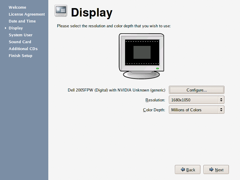

Just to make sure I re-installed Fedora Core 4 from the scratch and I've chosen Dell 2005FPW during the initial setup:
http://fedoranews.org/tchung/2005fpw...play_Setup.png

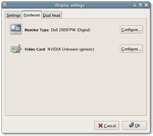

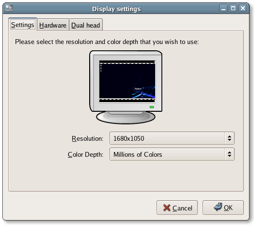

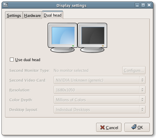

Here are few more screenshots from System-Config-Display from Fedora Core 4:
http://fedoranews.org/tchung/2005fpw...y_Settings.png
http://fedoranews.org/tchung/2005fpw...y_Hardware.png
http://fedoranews.org/tchung/2005fpw...y_Dualhead.png

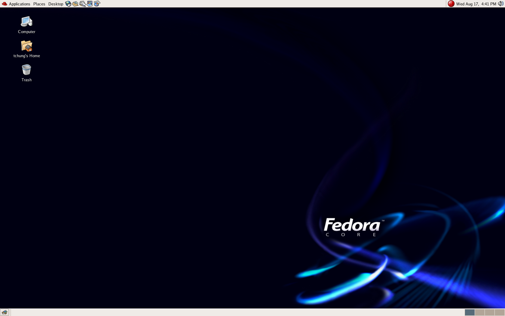

Here is the Entire Screen of Desktop with full 1680x1050 resolution:
http://fedoranews.org/tchung/2005fpw..._1680x1050.png
Once again, this was accomplished using DVI (Digital) connection.

From what I can tell, the package that determines what monitors one can select using the display preferences in Fedora ("system-config-display") is "hwdata".
In FC3, the latest release of hwdata is hwdata-0.146.1-1 which doesn't have an entry for the Dell 2005FPW.
FC4, however, comes with a later version that has data on that monitor. The install CD:s/DVD has hwdata-0.158.1, which according to TChung's tests would work fine. The latest version of that package for FC4 is hwdata-0.158.1-1 which also has the 2005FPW in its database.
Now, what I'm thinking is this: download the FC4 version of hwdata (hwdata-0.158.1-1.noarch.rpm ) and upgrade your current one using
# rpm -Uvh hwdata-0.158.1-1.noarch.rpm
and then try the display settings application again. That might let you select the 2005FPW and your /etc/xorg.conf should be updated properly.
Where to find that elusive hwdata RPM then? Well, visit your nearest FC4 mirror and look for it.
On one mirror I checked, it's in .../fedora/core/updates/4/i386 but the exact path might vary among mirrors.
Good luck!
