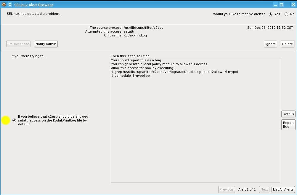

Now when I try to print I get this error
[IMG][/IMG]
So I want to generate a local policy to allow this driver to work. "SIGH" How the heck do I do that now? I tried some instructions in google but got lost.

Open a terminal and run:
grep /usr/lib/cups/filter/c2esp /var/log/audit/audit.log | audit2allow -M mypol
and then
semodule -i mypol.pp
SELinux is paranoid about these things but I don't recommend you disable it. When a message like this pops up and you're sure you want to allow whatever SEL is blocking, just run the 'fix command'. In this case the the fix command is the above script.

I tried the script this was the result.
colby@Fedora Documents$ grep /usr/lib/cups/filter/c2esp /var/log/audit/audit.log | audit2allow -M mypol
grep: /var/log/audit/audit.log: Permission denied
could not write output file: [Errno 13] Permission denied: 'mypol.te'
colby@Fedora Documents$ su
Password:
[root@Fedora Documents]# grep /usr/lib/cups/filter/c2esp /var/log/audit/audit.log | audit2allow -M mypol
compilation failed:
mypol.te:6:ERROR 'syntax error' at token '' on line 6:
/usr/bin/checkmodule: error(s) encountered while parsing configuration
/usr/bin/checkmodule: loading policy configuration from mypol.te
[root@Fedora Documents]# semodule -i mypol.pp
semodule: Failed on mypol.pp!

Next step might be to try setting SELinux to permissive which shows what errors you would havae gotten, but should let you print.

I also tried Permissive and tried to disable it completely I still get the same security error so I am clueless at this point.

I had to reboot after disabling Selinux. Now when I print I don't get the error but when I look at the job in the print que it says stopped with no way to start it. I tried adding port 9100 to the firewall just to see if that was it but no luck there either still shows the print job as stopped.
By the way what did I do by disabling Selinux LOL
---------- Post added at 11:23 PM ---------- Previous post was at 11:15 PM ----------
OK It looks like it's the driver itself. I now get idle - /usr/lib/cups/filter/c2esp failed
