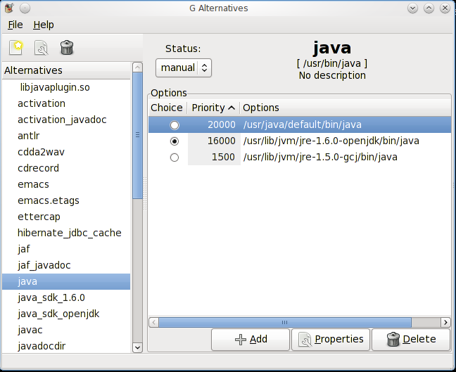

    Thank you Pablo Two. I already tried "yum reinstall java". The package java-1.6.0-openjdk was reinstalled when I tried the previous command. But the problem persisted.
    Thank you Hlinger. I ran galternatives(GUI frontend for alternatives) and there were multiple entries for java. I changed the one currently selected one for java from "/usr/java/default/bin/java" to "/usr/lib/jvm/jre-1.6.0-openjdk/bin/java". Now java is working.
    Thank you guys for the help. Fedora Forum rocks.

    do you have the same problem, i.e, the java binary is not found.
    If so, did u try changing the options in galternatives? If that is not working, post the "ls -l <galternatives entry for java>" output for all the entries for java in galternatives.
    Also this problem got solved, i.e., the links were set straight when i updated fedora
