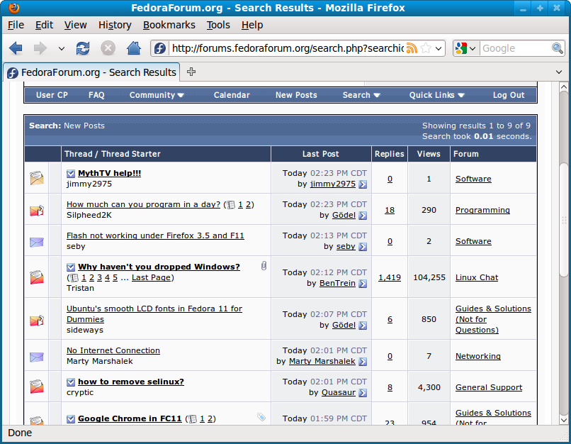

You mean ubuntu fonts don't you? Do your fedora fonts look as good as this:
(that's after applying ubuntu libs as described and installing MS TrueType Fonts
