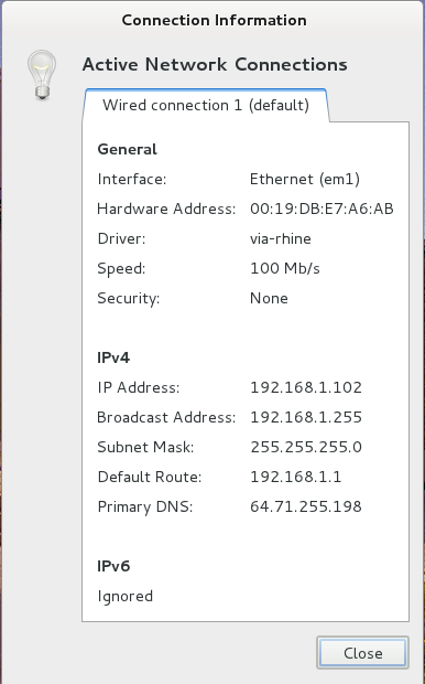

Usual networking (as working in fc15, and previously in fc16):

The problem is there's no route, (you showed it as blank and it shouldn't be) why I'm not sure I guess you've tried deleting the interfaces entry in NetworkManager and recreating it?
